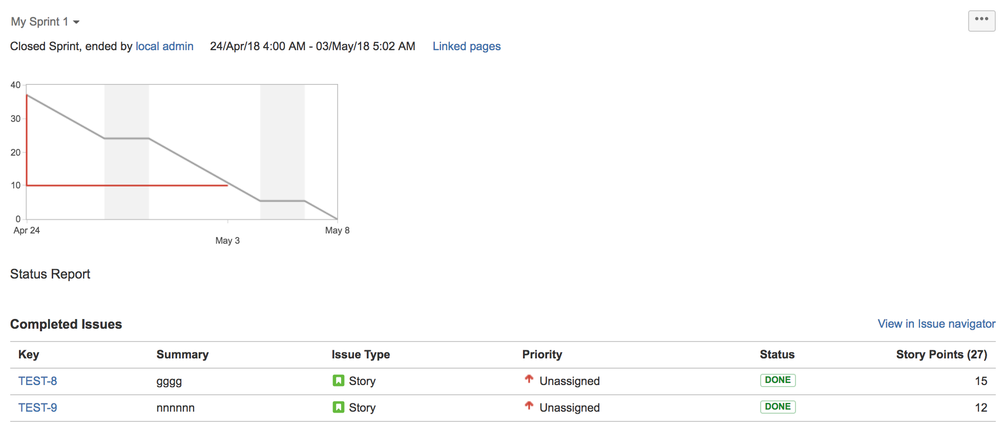

Here's an example sprint report for "My Sprint 1."
Example issue TEST-8 contains 15 story points, and issue TEST-9 contains 12. Both issues are completed in this sprint, so Story points burned in this sprint total 27:
screenshot of report for my sprint 1 with 27 story points.

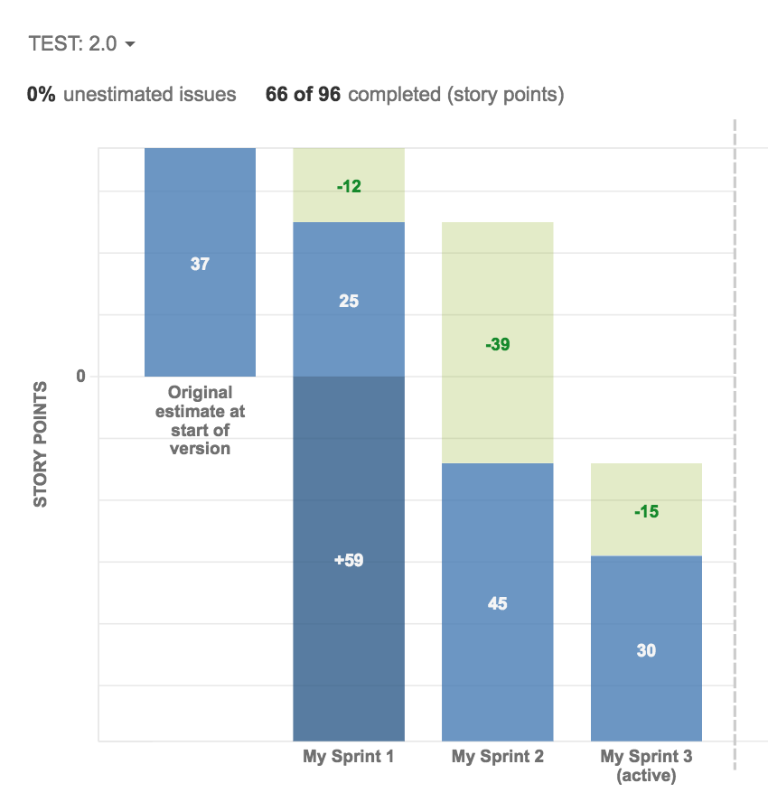

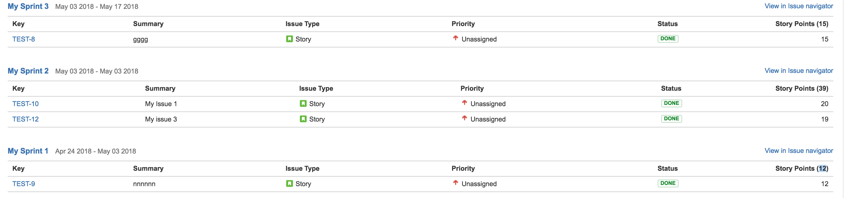

Release burndown report:
screenshot of release burndown report. my sprint 1 now only includes 12 burned story points and my sprint 3 contains 15.
screenshot of details in report. issue test-8 is now associated with my sprint 3 instead of my sprint 1.
Notice that completed Story points for "My Sprint 1" are now 12 and "My Sprint 3" are now 15. TEST-8 is linked to "My Sprint 3" instead of "My Sprint 1."
