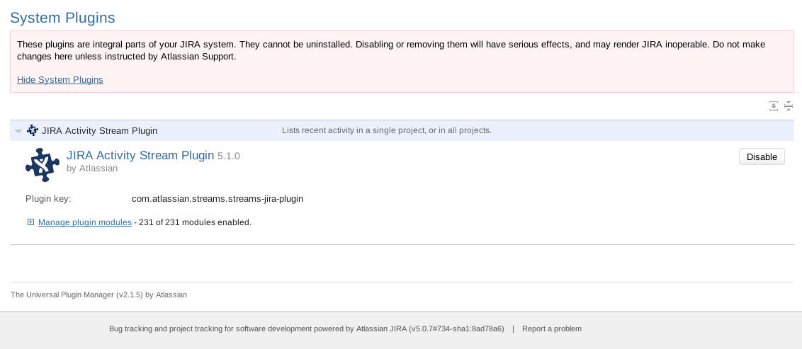

It happens because a Bug currently undergoing investigation (STRM-2168) on Activity Stream version 5.x As shown in the screenshot below:
