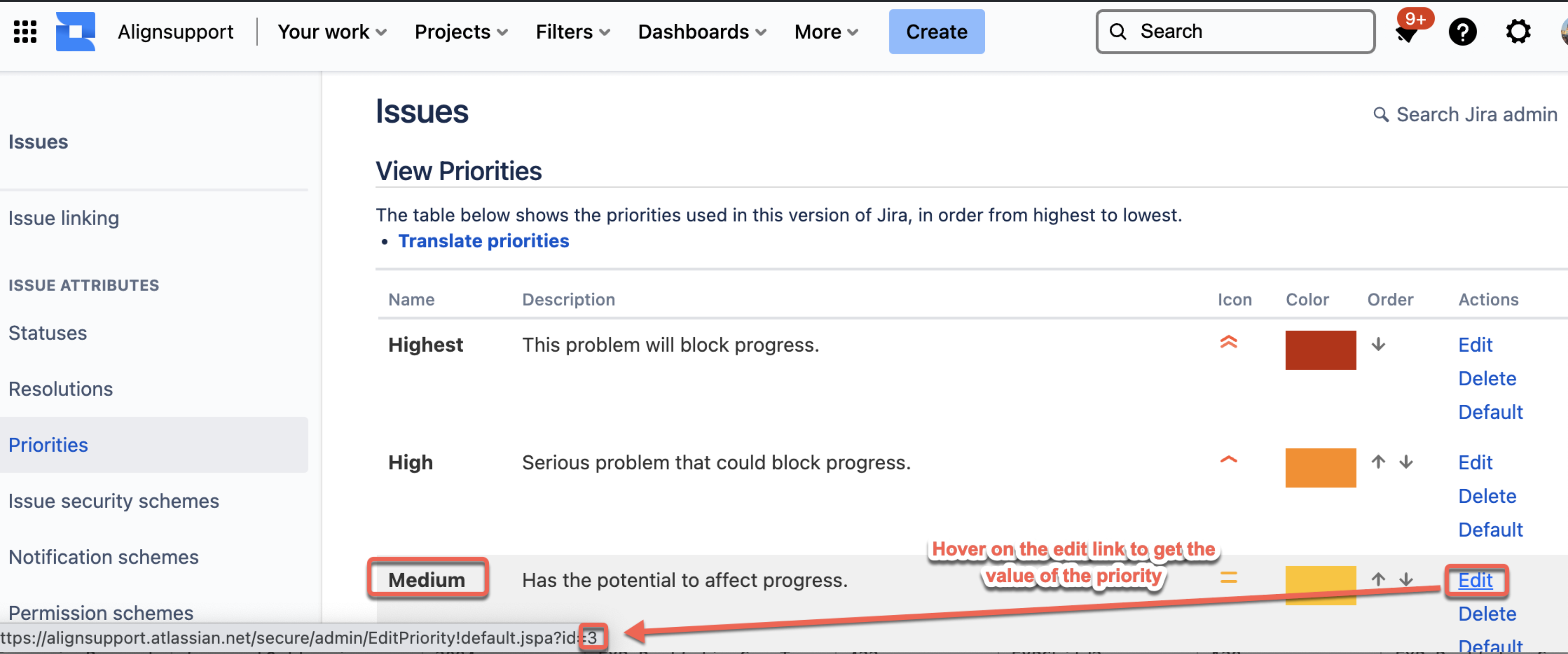

To know which value corresponds to which priority, you can hover over the ‘edit’ link of the priority in the Jira Administration as shown below:
Hovering over the Edit option for the priority will display a URL at the bottom of the browser, which has the ID at the very end.
