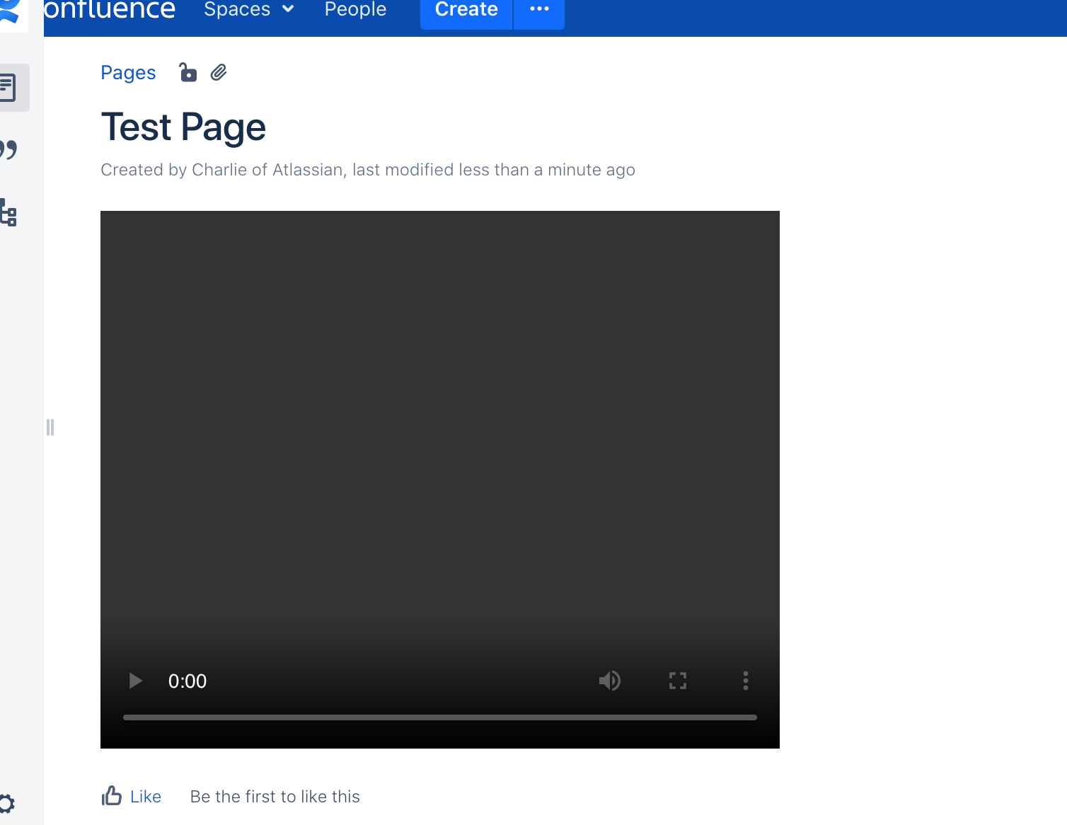

  1. Create a new Page.
  2. Attach a video file.
  3. Include the Multimedia Macro and select the attached video.
  4. Save the Page.
  5. Check the results.
✔️ Expected outcome: the video plays just fine like in other Confluence Pages.
Actual result: the video fails to be reproduced.
