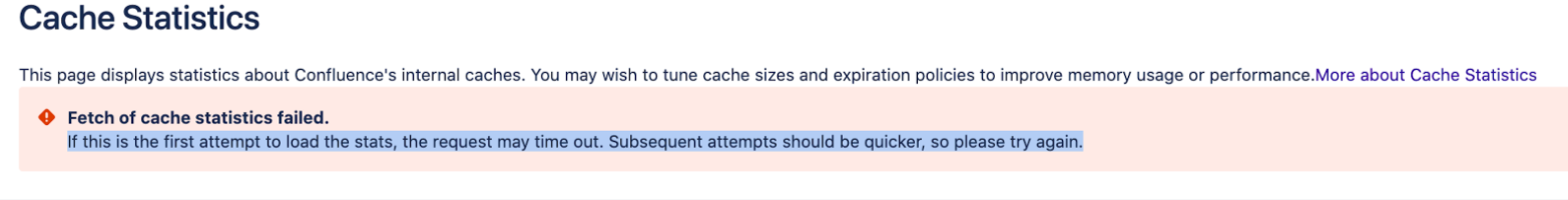

If you find this stack trace, it is very likely that when you try to flush the cache or access the Cache Statistics page, you observe the following errors:
  • Flush the cache on the Confluence node first via the REST API endpoint will fail with HTTP status code 500 Internal Server Error:
curl -u <adminUsername>:<adminPassword> -X DELETE "http://CONFLUENCE_URL/rest/cacheManagement/1.0/cacheEntries"
  • Trying to access the Cache Statistic page throws "Fetch of cache statistics failed":
http://CONFLUENCE_URL/admin/cache/showStatistics.action
