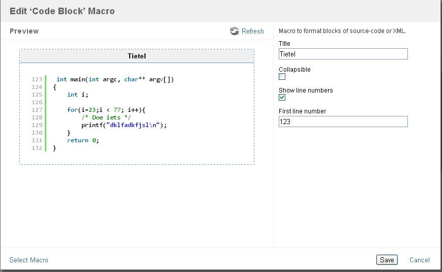

  • 'Syntax highlighting' and 'Theme' settings were not visible in Code Macro configuration window:
  • All Code Macro plugin modules were enabled but the issue persists
