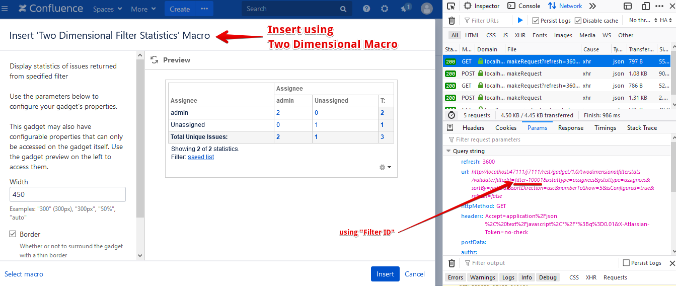

Moreover, there are two different ways of adding the Two Dimensional macro in Confluence:
  1. Inserting a Jira Chart and selecting the Two Dimensional macro in the pop-up window
  2. Inserting the Two Dimensional macro directly
If the Two Dimensional macro was added using method 1, it will try to retrieve the JIRA filter using the filter Name:
Insert Jira Chart
If the Two Dimensional macro was added using method 2, though, it will try to retrieve the JIRA filter using the filter's ID:
Insert using Two Dimensional Macro.
Depending on which way this macro is added in Confluence's pages, there might be a problem loading the gadget. Using the first method with a lengthy filter will not render the expected results while using the second approach will render it correctly.
  • If the error persists after adding the timeout values, use the second method to add the Two Dimensional macro
