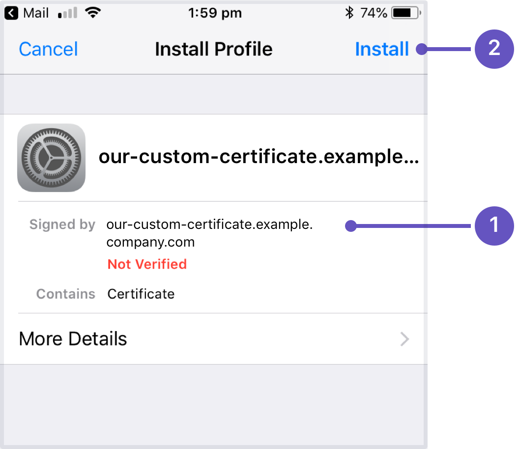

  2. The Install Profile screen will appear. Check the certificate details are correct (1) then tap Install (2).

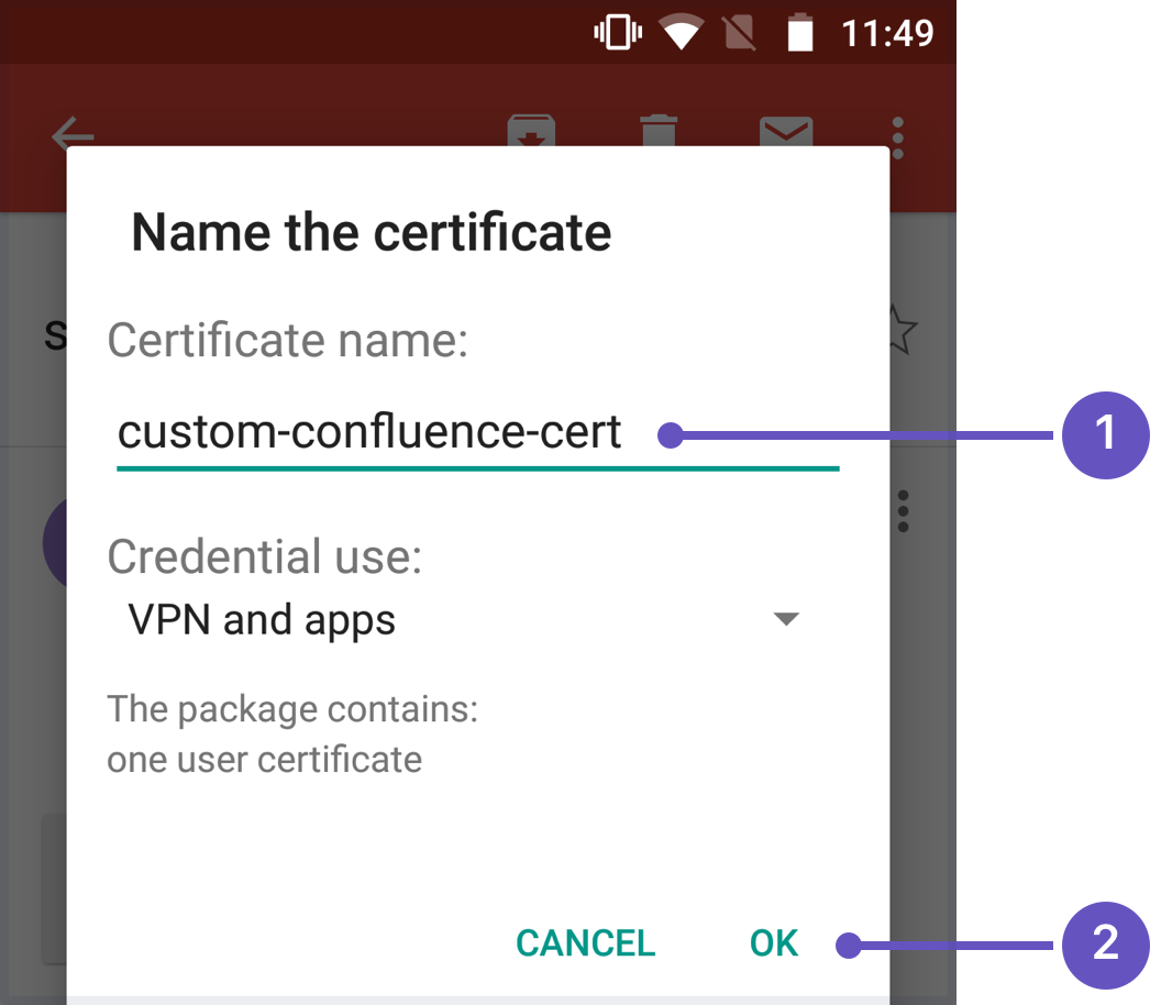

  2. When prompted, name the certificate (1).
  3. Follow the prompts to install the certificate (2).

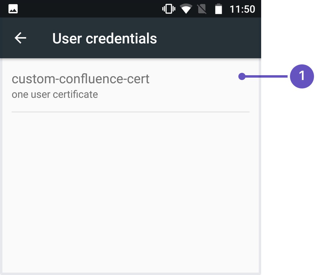

  4. You can verify that the certificate has been installed at Settings > Security > TrustedCredentials > User (1).
