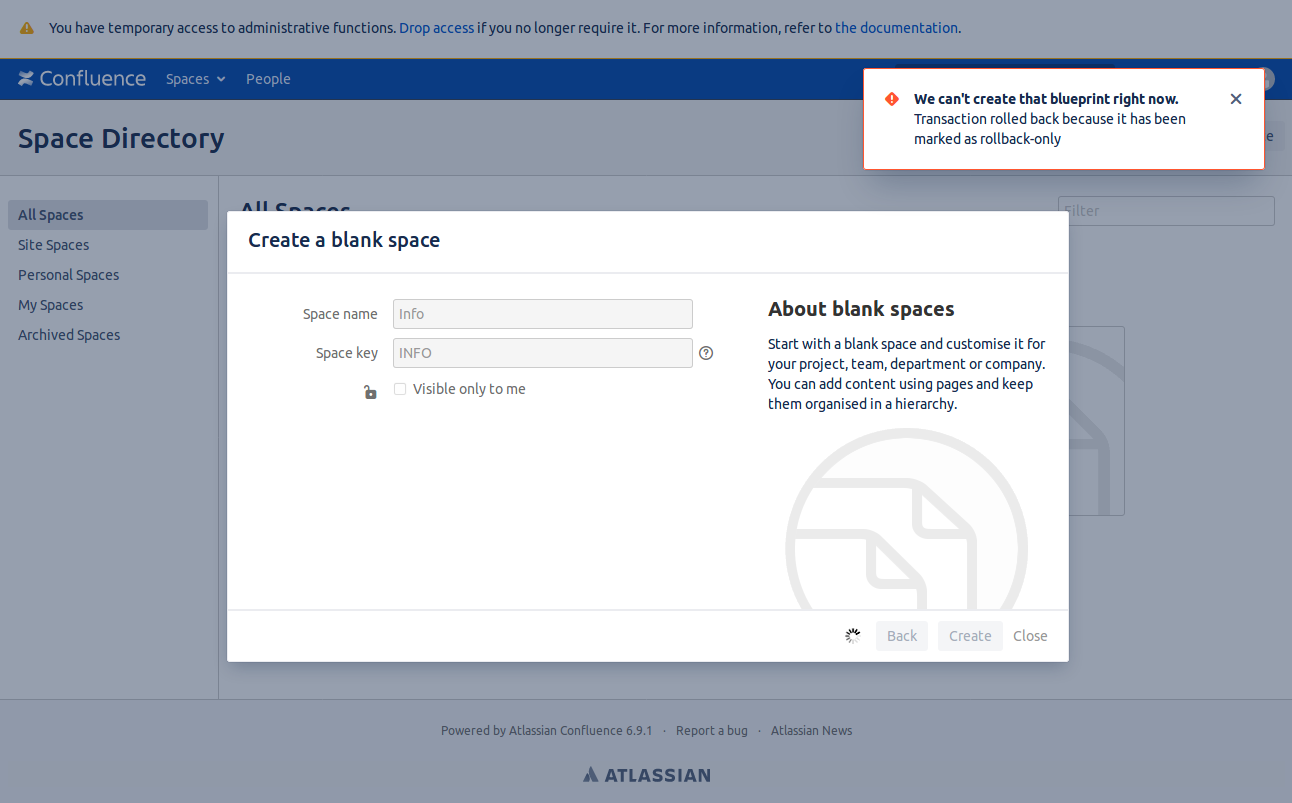

A space can't be created due to the error below.
The atlassian-confluence.log file will display errors as such:
2018-06-23 16:19:22,751 ERROR [http-nio-8095-exec-2] [atlassian.confluence.event.ConfluenceEventDispatcher] run There was an exception thrown trying to dispatch event [com.atlassian.confluence.event.events.content.mail.notification.ContentNotificationAddedEvent[source=com.atlassian.confluence.mail.notification.DefaultNotificationManager@961b8b6]] from the invoker [com.atlassian.confluence.event.ConfluenceListenerHandlersConfiguration$TimingListenerHandler$1$1@2a4e0967] -- referer: http://localhost:8090/spacedirectory/view.action | url: /rest/create-dialog/1.0/space-blueprint/create-space | traceId: 4e99dd9e50594db4 | userName: admin java.lang.RuntimeException: bundle [com.atlassian.mywork.confluence-host-plugin]. Listener: com.atlassian.mywork.providers.confluence.ConfluenceEventListener event: com.atlassian.confluence.event.events.content.mail.notification.ContentNotificationAddedEvent ... Caused by: java.lang.RuntimeException: Could not read fields for table AO_9412A1_AONOTIFICATION at net.java.ao.schema.helper.DatabaseMetaDataReaderImpl.getFields(DatabaseMetaDataReaderImpl.java:139) at net.java.ao.schema.ddl.SchemaReader.readFields(SchemaReader.java:126) at net.java.ao.schema.ddl.SchemaReader.readTable(SchemaReader.java:110) ... Caused by: java.sql.SQLSyntaxErrorException: Unknown table 'AO_9412A1_AONOTIFICATION' in information_schema
The errors may also occur for other tables.
Caused by: java.sql.SQLSyntaxErrorException: Unknown table 'AO_26DB7F_ENTITIES_TO_ROOMS' in information_schema
Caused by: java.sql.SQLSyntaxErrorException: Unknown table 'AO_5FB9D7_AOHIP_CHAT_LINK' in information_schema
