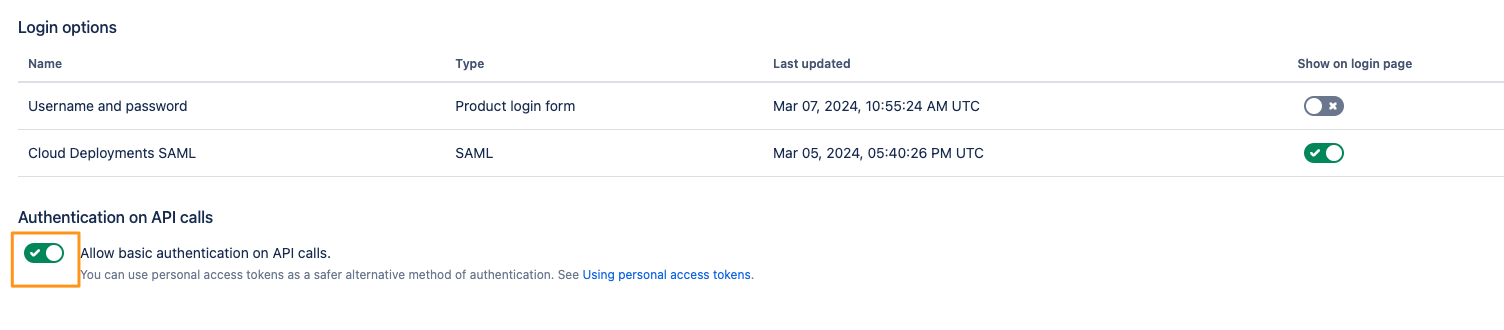

When Basic Authentication (Username and Password) is disabled from the Login Page as well as for REST API (Allow basic authentication on API calls disabled):
Scenario 1 internally covers two different use cases:
Use Case 1
Bitbucket System Admin user present as an Internal Directory user in Bitbucket and it has been added to the allowed_users list before disabling Basic Authentication completely (from both the Login Option and API calls):
  • To know how to add a user in advance to the allowed_users list before “Allow basic authentication on API calls” will be disabled, follow this KB: Creating an allowlist when basic authentication is disabled
  • Initially, (when the System Admin user “admin” is already added to allow list above), check the options under Authentication Methodspage on the Bitbucket Administration page:

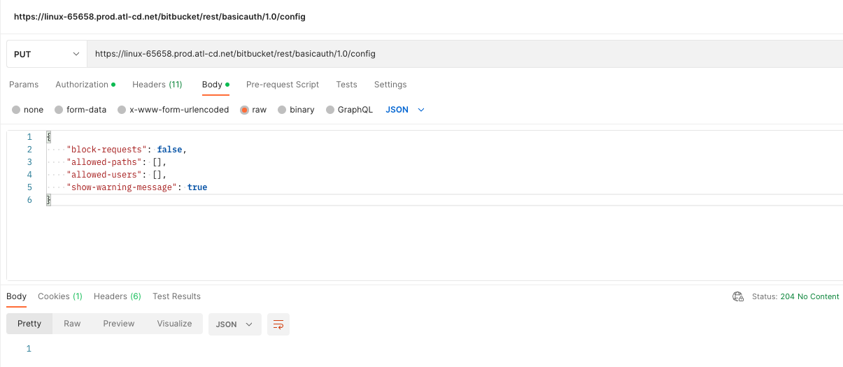

  • While running an API call using an already added System Admin user of the internal directory: API result: (GET call). It represents that block-requests are set to true which needs to be set to false to let users login to the Bitbucket.
  • To resolve this scenario, run the PUT call to change the block request to false using the admin user:
Once done, follow the steps under the Scenario 2 heading below to resolve the issue.

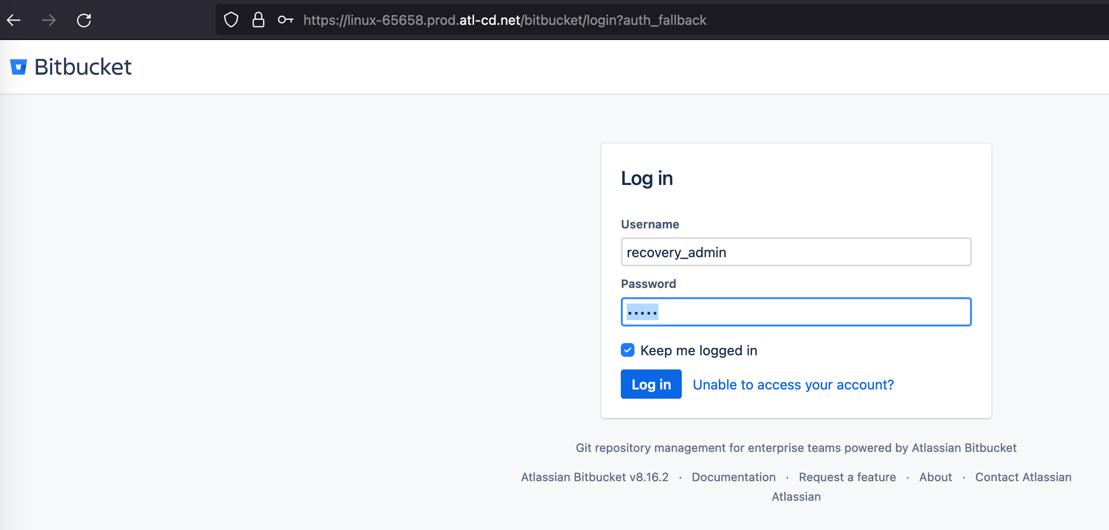

  • Now use the user as recovery_admin user, enable the auth_fallback, and login to Bitbucket.

When Basic Authentication is disabled from the Login Page but “Allow basic authentication on API calls” is enabled:
If the user has a system admin user in the internal directory: Just need to enable auth_fallback using the article and login with the system admin user.
If the user doesn’t have a system admin user in the internal directory: Need to enable lockout recovery first to get the recovery_admin user. Once done, enable auth_fallback with the help of recovery_admin user and login. Once it is done, apply the required changes and initiate the LDAP synchronization.
