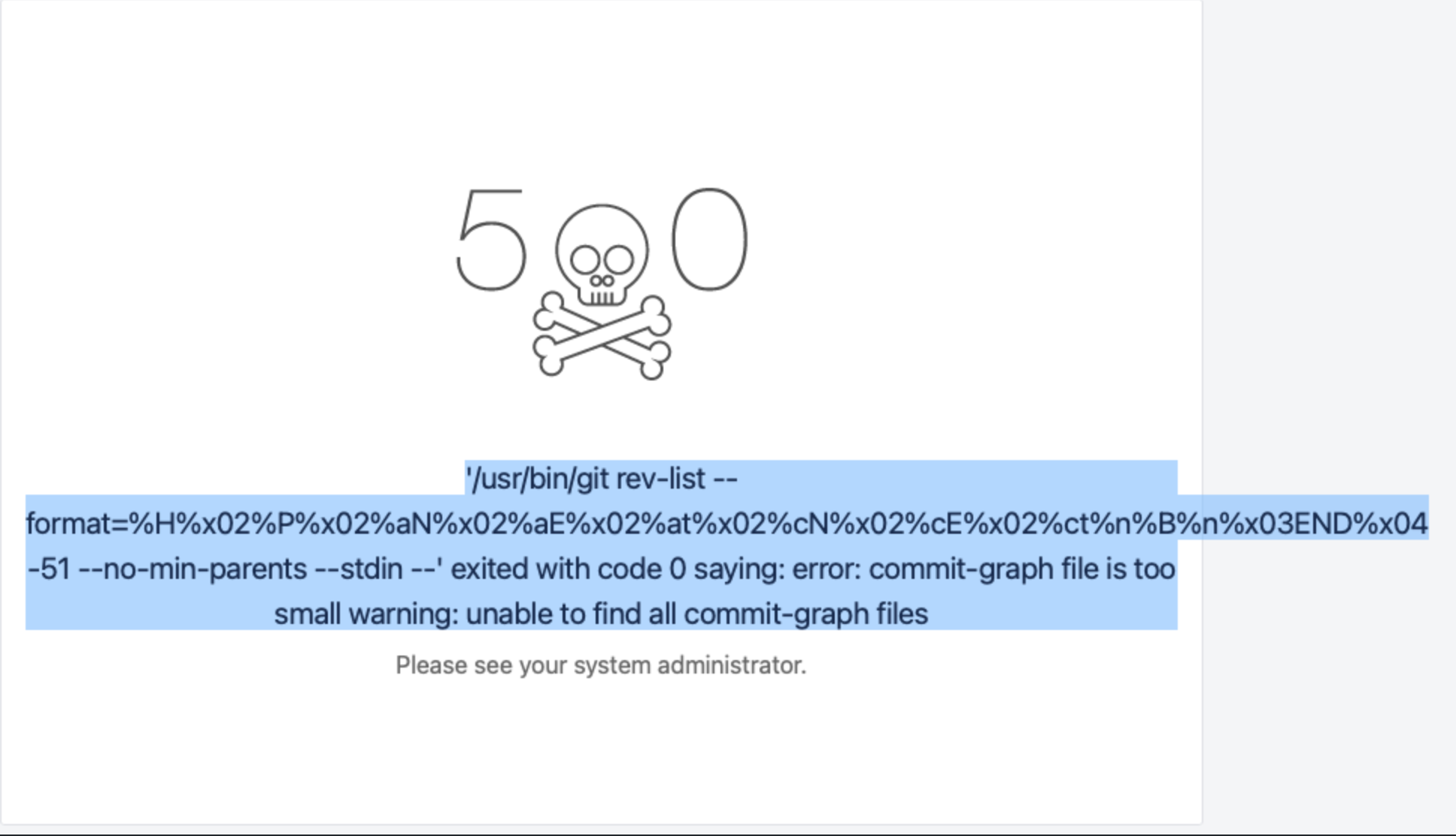

While viewing the commits page of a repository, an Error 500 screen is shown. Please refer to the screenshot below.

2023-07-24 10:26:27,797 ERROR [http-nio-7990-exec-8] admin *17LM0IBx626x423138x0 1g24rke xx.xx.xx.xx,xx.xx.xx.xx "GET /projects/PRJ/repos/test-repository/commits HTTP/1.1" c.a.s.i.w.HandlerExceptionResolverImpl '/usr/bin/git rev-list --format=%H%x02%P%x02%aN%x02%aE%x02%at%x02%cN%x02%cE%x02%ct%n%B%n%x03END%x04 -51 --no-min-parents --stdin --' exited with code 0 saying: error: commit-graph file is too small warning: unable to find all commit-graph files com.atlassian.bitbucket.scm.CommandFailedException: '/usr/bin/git rev-list --format=%H%x02%P%x02%aN%x02%aE%x02%at%x02%cN%x02%cE%x02%ct%n%B%n%x03END%x04 -51 --no-min-parents --stdin --' exited with code 0 saying: error: commit-graph file is too small warning: unable to find all commit-graph files
