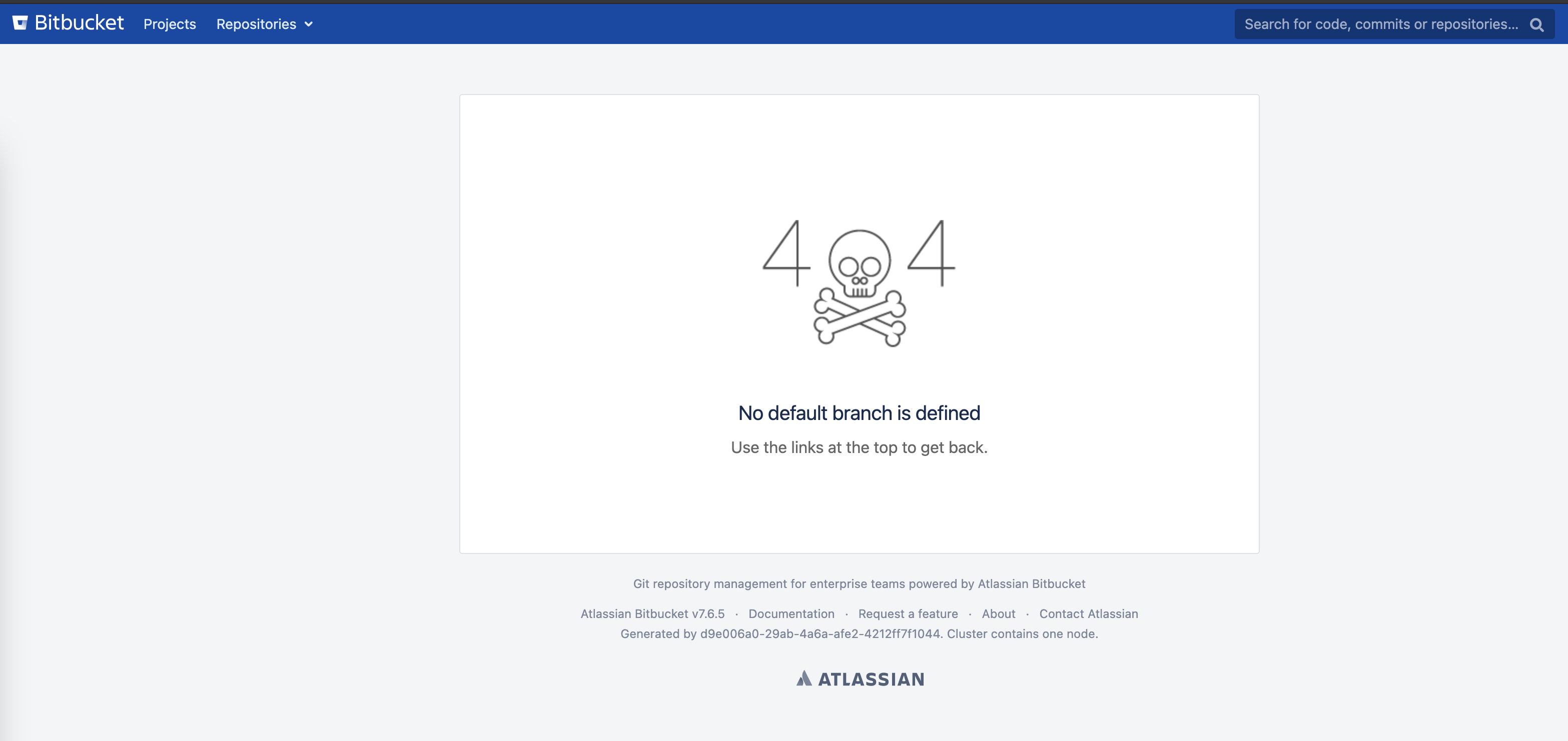

When attempting to access a repository, Bitbucket displays a 404 error page stating that "No repository with slug <REPOSITORY_SLUG> exists in the project <PROJECT_NAME>."
Bitbucket may also throw the 404 error "No default branch is defined."
