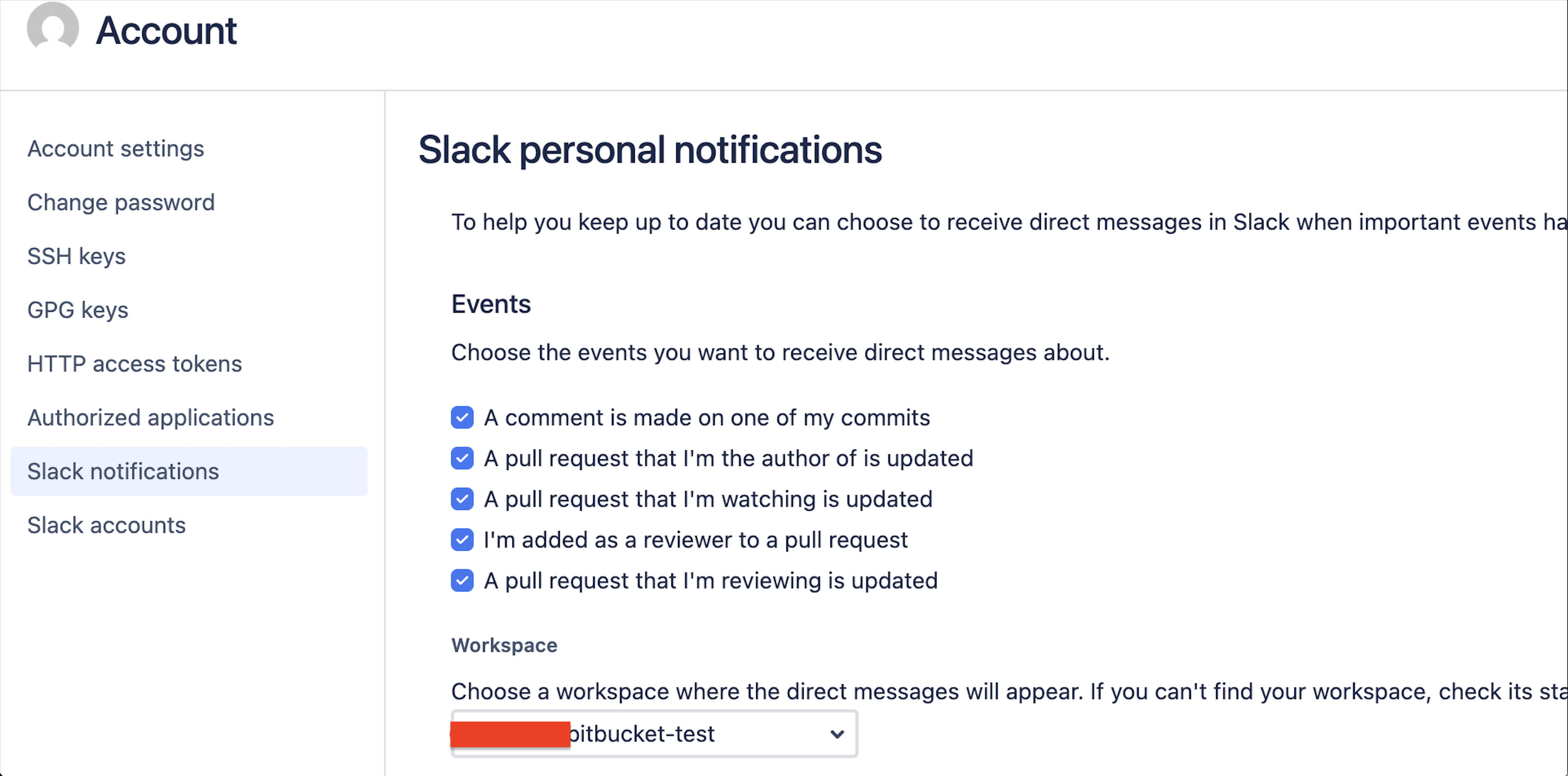

To access your personal notification settings, go to your User Profile > Manage Accounts > Slack Notifications.
User profile notification settings

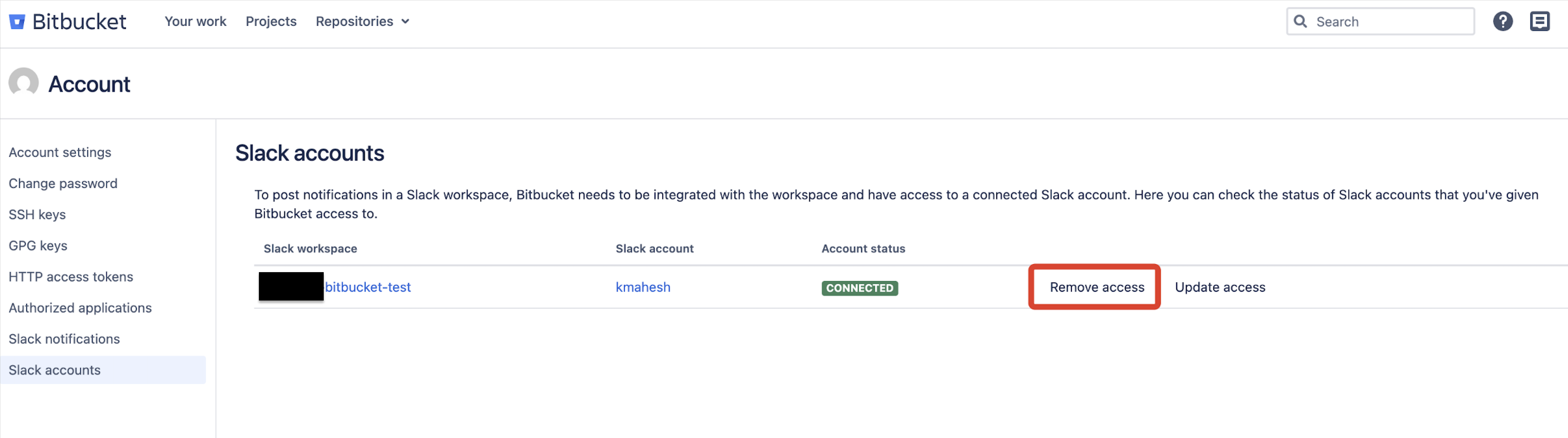

    2. Remove access of the old Slack workspace
      Manage Slack accounts remove access

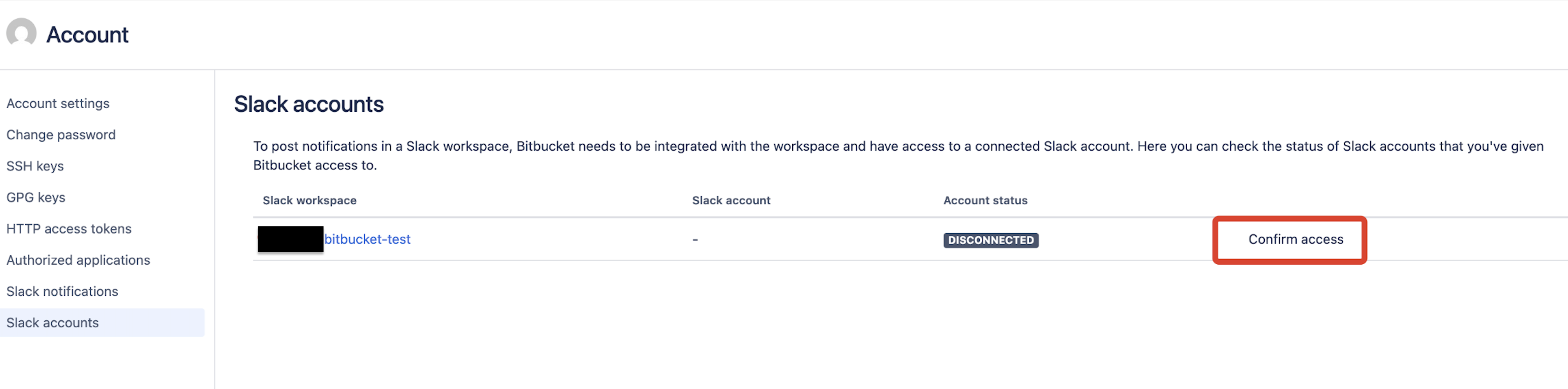

    3. Confirm access of the new Slack workspace
      Manage Slack accounts confirm access
