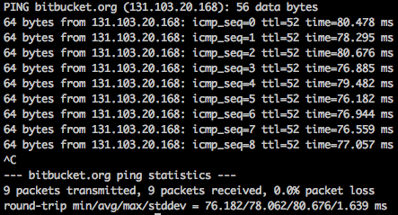

If you're in an office with an issue, contact your local network administrator to be sure that they aren't blocking/slowing connections. You can sometimes test this by running a ping or traceroute to bitbucket.org. You should see ~ 10-100ms responses depending on where you are located geographically.
ping bitbucket.org
traceroute bitbucket.org

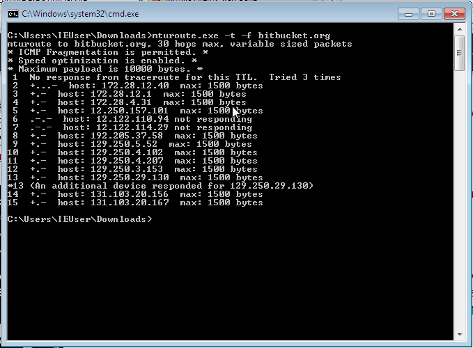

Check the MTU
If you're on DSL, a possible issue could be a larger than expected MTU size being forced somewhere along the way, this can cause packet fragmentation and loss in some cases. You can check this with a utility called mturoute.exe – http://www.elifulkerson.com/projects/mturoute.php
mturoute.exe -f -t bitbucket.orgYou should see output similar to the below:
