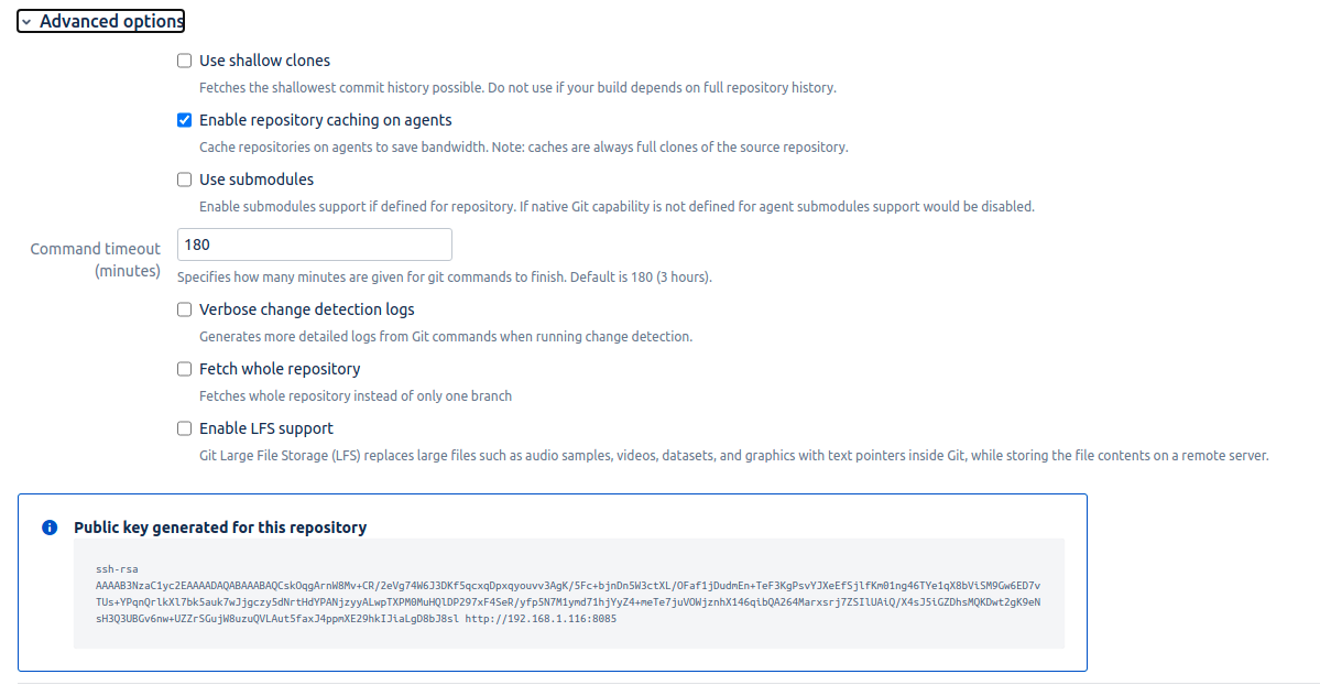

    1. Copy SSH key from the advanced settings of the main repository in Bamboo:

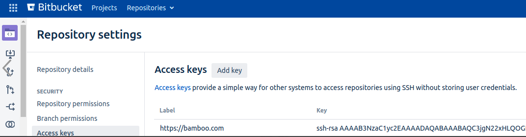

    2. Save the key as Access Token in Bitbucket server repository settings:
