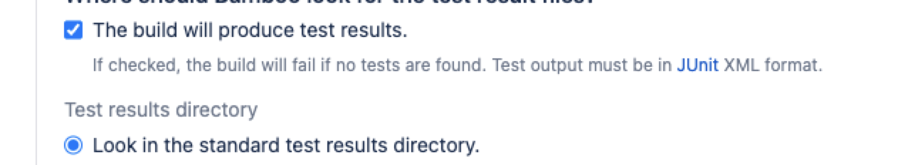

  • The solution for this Issue is to segregate build and test Parsing tasks separately.
  • For the maven builder task, uncheck the option "The build will produce test results."
  • Later the test cases can be parsed using separate Junit Parser task Type, more details at JUnit Parser
