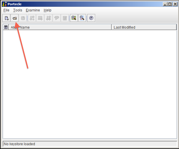

Using Portecle
  1. Download and install the Portecle app onto the server that runs your application.
    This is a third-party application and not supported by Atlassian.
  2. Ensure the <JAVA_HOME> variable is pointing to the same version of Java that your application uses. See our Setting JAVA_HOME docs for further information on this.

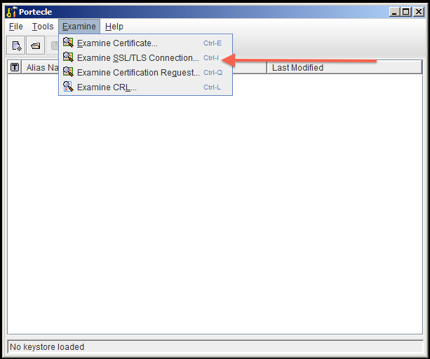

  3. Select the Examine menu and then click Examine SSL/TLS Connection:

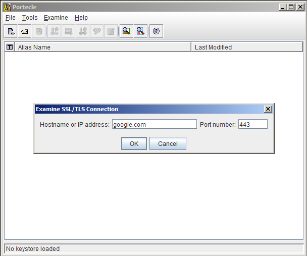

  4. Enter the SSL Host and Port of the target system:

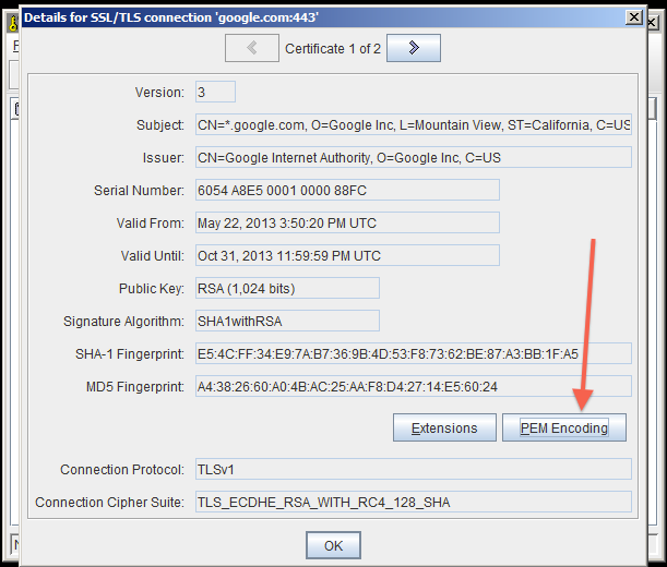

  5. Wait for it to load, then select the public certificate and click on PEM:
  6. Export the certificate and save it.
  7. Go back to the main screen and select the Open an existing keystore from disk option, select the truststore file (for example $JAVA_HOME/lib/security/cacerts) then enter the password (the default is changeit).

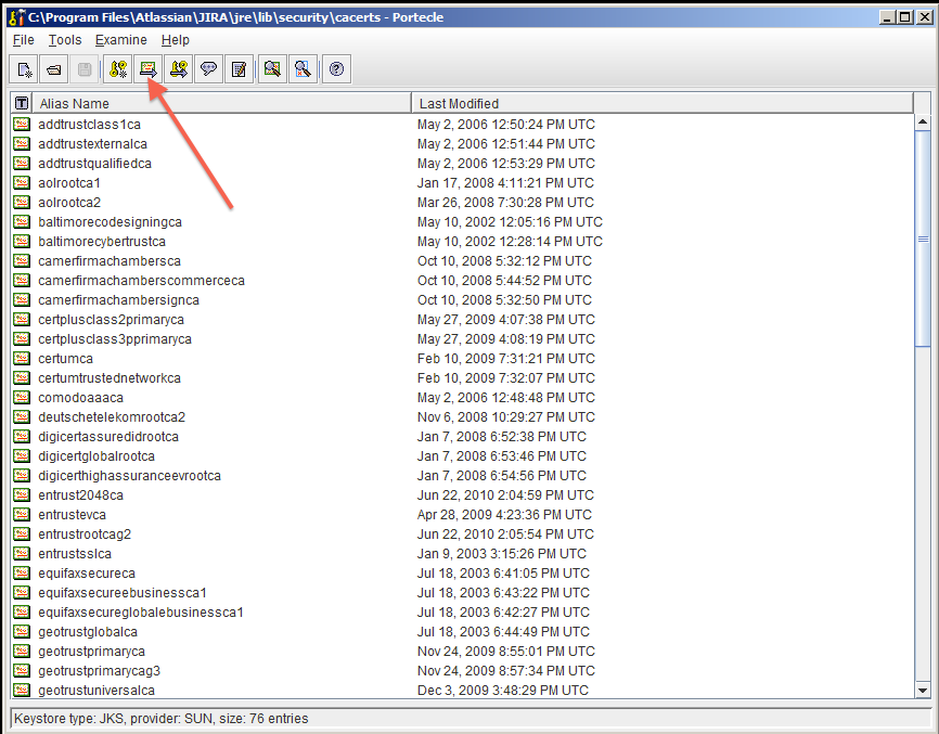

  8. Select the Import a trusted certificate into the loaded keystore button:

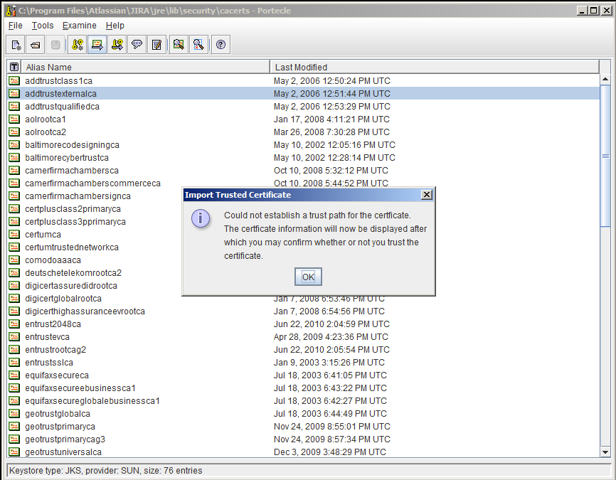

    1. You may hit this error:
    2. If so, hit OK, and then accept the certificate as trusted.

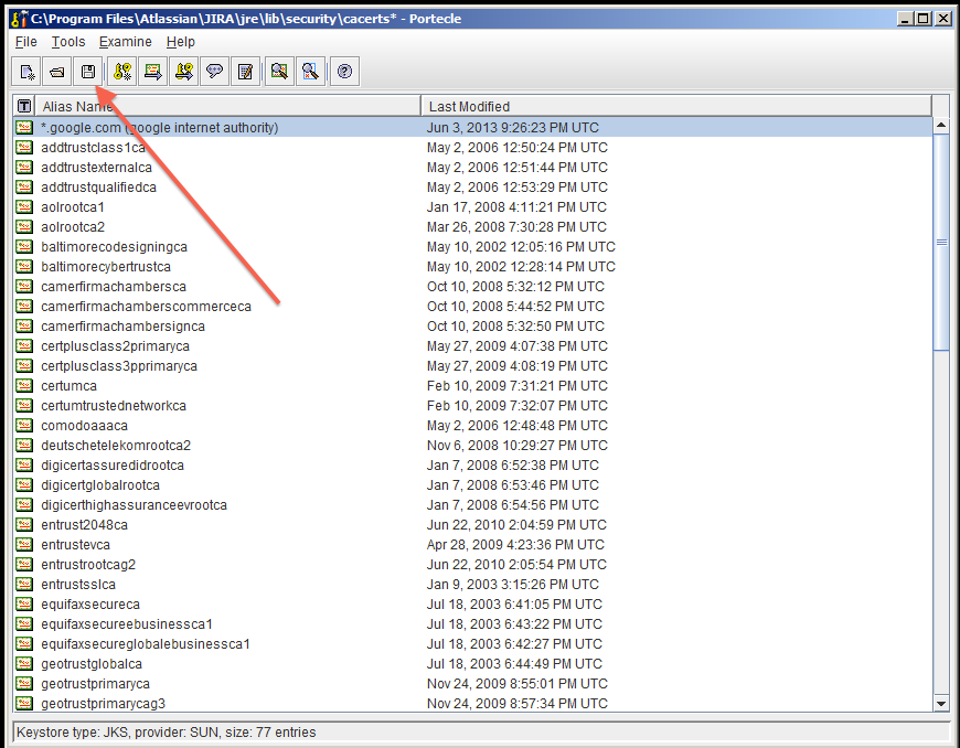

  10. Save the keystore to disk:
